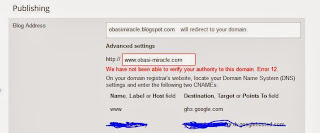

as seen in this pix below
for CNAME records use
CNAME (Alias) as "www" pointing to "ghs.google.com" as seen in this pic below
Finally you need log in to your blogger dashboard and change the address to the custom domain name you have chosen as seen in this picture below.
Remember to add the short security code google will give to you as CNAME (Alias) pointing to the long security code.
Now your blog should be loading from a custom domain name.
