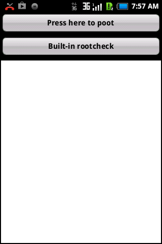

To Root your tecno N3 Phone Using  POOT apk and MINISTRO II apk Do the following :
Download: Poot Tecno n3
Download: Ministro II library(from Google play store)
To ROOT your TECNO N3 is simple
Just install POOT apk to internal memory and run the apps. it will require you to install MINISTRO II, you'll get -error like "update minstro library", just update through google play store.
Then proceed again to the next step. After installing and updating all the libraries of QT, your phone will automatically reboot(or reboot manually)
You'll get two buttons
1. "press here to poot"
2. "built in root check
Click on the first button to poot and wait till you have 3 buttons
, That means you are now rooted.
You can now complete the process by downloading super user application from the play store
N/b this isn't my findings at all but rather from a good friend blog post here

Step 1:
Download the Poot.apk and place it somewhere on you phone, internal storage or sd card, either will work.
Download Poot-debug.apk from this link
Step 2:
Download the ministro-ii.apk and place it somewhere on your phone.
you can download it from this link
Step 3:
Install both the Poot.apk and ministro-ii.apk. (You will need to make sure that you have enabled "Unknown Sources" under the application settings menu of your phone before you will be able to install these apks.)
Step 4:
After both apks are installed open Poot. It will open up ministro and download quite a few libraries that are necessary for the Poot to work. Once it has completed click the button that says "Press here to poot" and hope for the best.
Step 5:
Pay attention the the messages displayed on the screen. Most messages should start with a [+], but you should see a couple of [-].
As long as the only warning messages you receive are the following, you should have successfully rooted.
[-]current && current != last + 1: 0000ffff 0000ffff
[-]Haxx has run its coarse. Reboot the device to play again
A demon materialized while pooting. Error code: 64
You will receive these messages because Poot does not recognize the M865c kernel and is unable to clean things up without rebooting.
Again, the three warnings listed above are nothing to worry about.
Step 6:
Reboot your phone to save changes and allow the exploit to take effect.
Step 7:
Open Poot and click on the button that says Built-in rootcheck to verify that your phone is rooted. As long as Poot is able to find 'su,' and it will display its path along with a corresponding message stating success.
Step 8:
Install the superuser app from the google play store. This app is necessary to run other apps as root.
Step 9:
You can now uninstall Poot and ministro, if you like. This should save you a little bit of space since the M865c has limited internal storage.
Step 10:
Thank giantpune for all of his work and consider donating to him because he did all of the work on this. I am only detailing my experience, he deserves all of the credit.
step 11 :
You may wanna read his original steps or wanna download poot debug.apk and ministro-ii.apk from his own thread here
